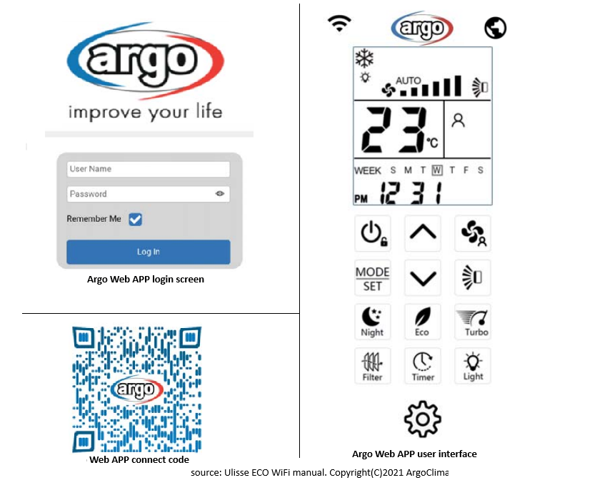

The binding provides support for ArgoClima (opens new window) Wi-Fi-enabled air conditioning devices which use Argo Web APP for control. Refer to Argo Web APP details section for an example.
IMPORTANT: The same vendor also manufactures HVAC devices supported by a phone application (opens new window).
These devices are using a different protocol and are not supported by this binding. There are good chances these will be supported by the Gree (opens new window) binding, though!
The binding supports all HVAC remote functions (including built-in schedule and settings) except for iFeel (room) temperature which is not supported by the Argo remote protocol and has to be sent via infrared. The binding can operate in local, remote and hybrid modes. Refer to Connection Modes for more details.
See also Argo protocol details to find out more about how the device operates.
# Supported Things
remote
: Represents a HVAC device which is controlled remotely - through vendor's web applicationlocal
: Represents a locally available device, which openHAB interacts with directly (or indirectly, through a stub server). Refer to Connection Modes for more details.
The binding has been primarily developed and tested using Ulisse 13 DCI ECO Wi-Fi (opens new window) device.

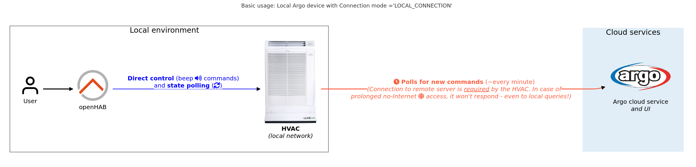

hostname | text | Hostname or IP address of the HVAC device. If useLocalConnection setting is enabled, this address will be used for direct communication with the device. | N/A | yes | no |
connectionMode | text | Type of connection to use. One of: LOCAL_CONNECTION , REMOTE_API_STUB , REMOTE_API_PROXY . Refer to Connection Modes | LOCAL_CONNECTION | yes | no |
hvacListenPort | integer | Port at which the HVAC listens on (used if useLocalConnection== true ) | 1001 | no | yes |
localDeviceIP | text | Local IP address of the device for matching intercepted requests (may be different from hostname, if behind NAT). Used in REMOTE_API_* modes. | N/A | no | yes |
deviceCpuId | text | CPU ID of the device. Optional, value is used for detecting device update in proxy mode. Used in REMOTE_API_* modes. | N/A | no | yes |
useLocalConnection | boolean | Whether the binding is permitted to talk to the device directly. | yes | no | yes |
refreshInterval | integer | Interval the device is polled in (in sec.). Used if useLocalConnection== true | 30 | no | yes |
