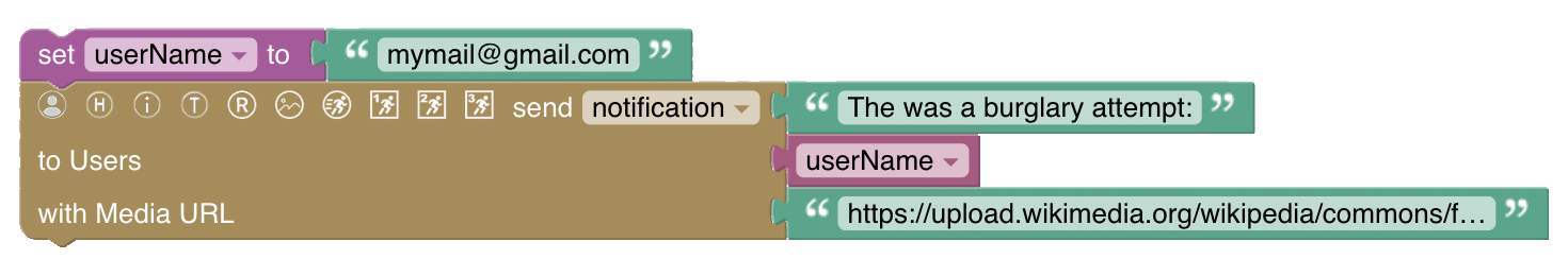

# Send Notification to specific cloud email user
Function: Sends a notification to the openHAB mobile app via openHAB cloud to a specific user signed up under the given email address
- This block does not use the mail binding, and it is not possible to send a notification to a user who does not have an openHAB cloud account.
- Notification will only work if devices have the openHAB mobile app installed (either iOS or Android)

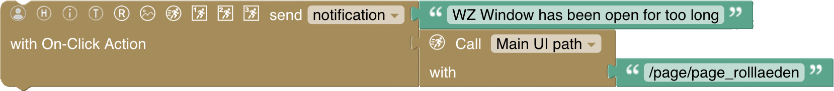

# Send Notification to All Devices and users
Function: Sends a notification to all devices and all users to the openHAB mobile app.

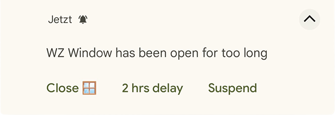

Example Push Message shown under Android:
- A message can be provided together with an icon that should be shown on the device. Use the icon names of the openHAB iconset (opens new window).
- The notification can also be viewed at https://myopenhab.org/notifications (opens new window)
