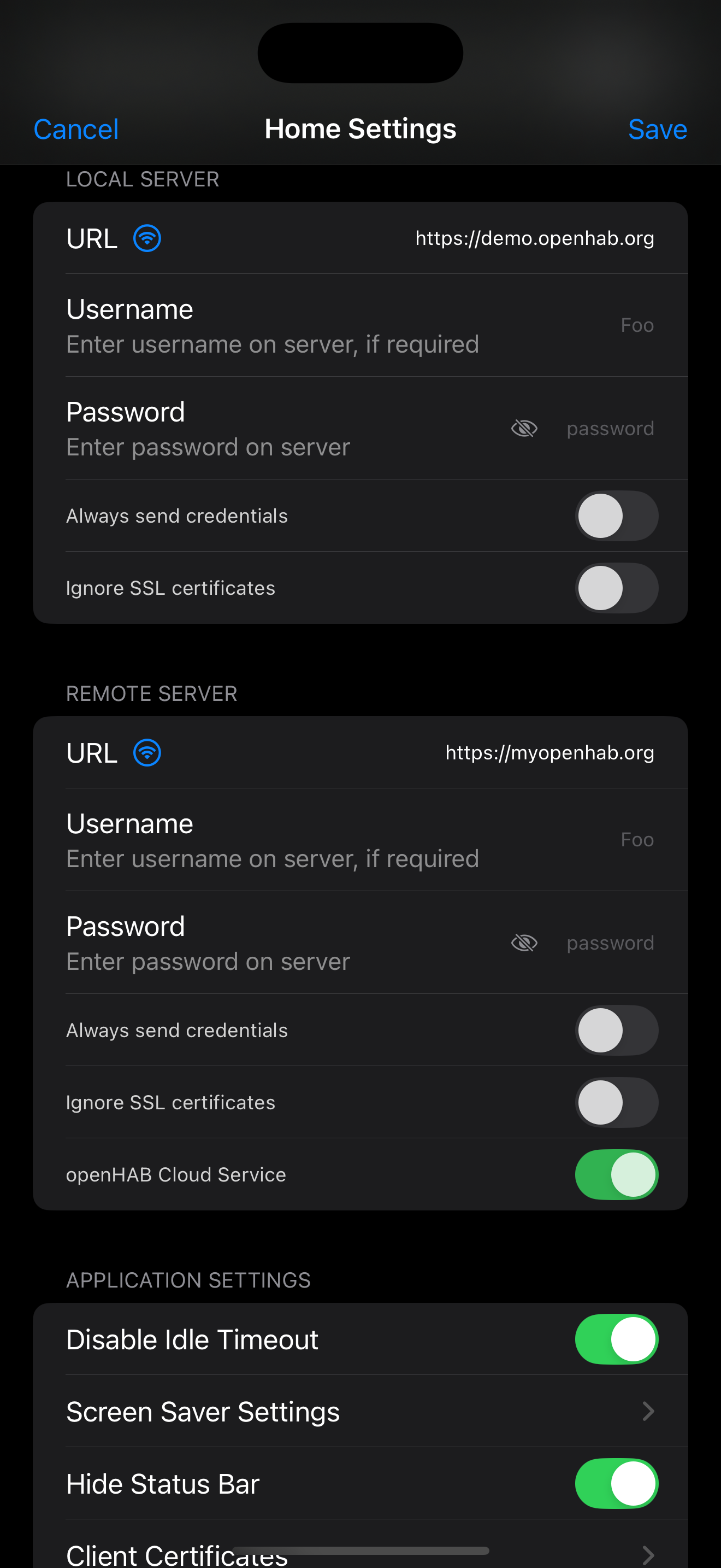

# Connection Settings
The app will try and connect using the Local URL as the primary connection, and if that fails or is not reachable, falls back to the Remote URL.
# Demo Mode
This sets up the app to use the openHAB demo server and can be used to experience the app without needing to install openHAB.
# Local URL
This is the primary connection to your openHAB instance, a fully qualified URL with a IP or host is required.
Example:
https://openhab.local:8443
# Remote URL
This is the secondary connection to your openHAB instance, a fully qualified URL with a IP or host is required.
If using the openHAB cloud service, leave this as the default setting of https://myopenhab.org
When set to the public cloud, the app will also register for push notifications (as long as credentials are correct)
Example:
# Username / Password
This will be sent if the local or remote server challenges for authentication, or if "Always Send Credentials" is checked on. If using the openHAB cloud, these should be set to those login credentials.

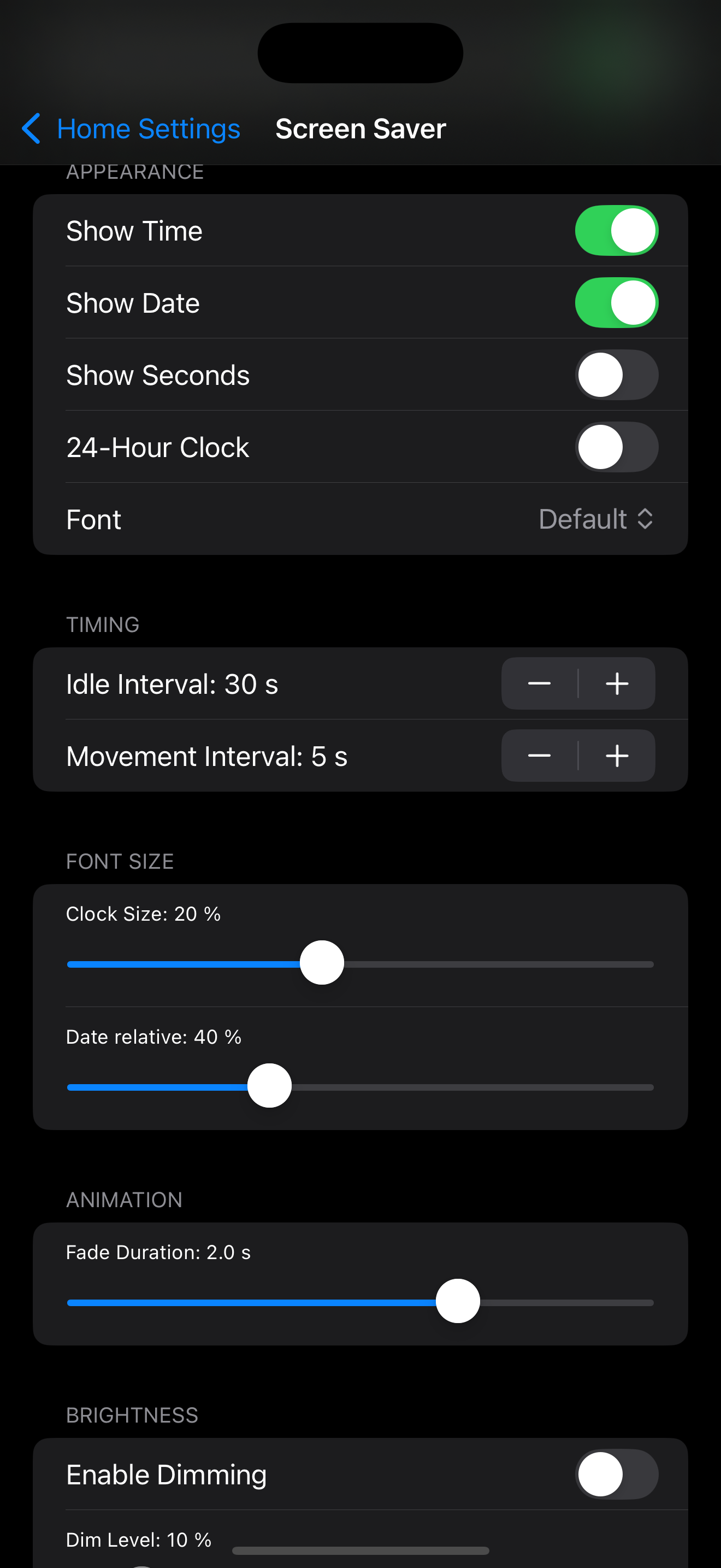

# Idle Timeout
Useful for wall or fixed installations, will disable the Idle screen timeout.

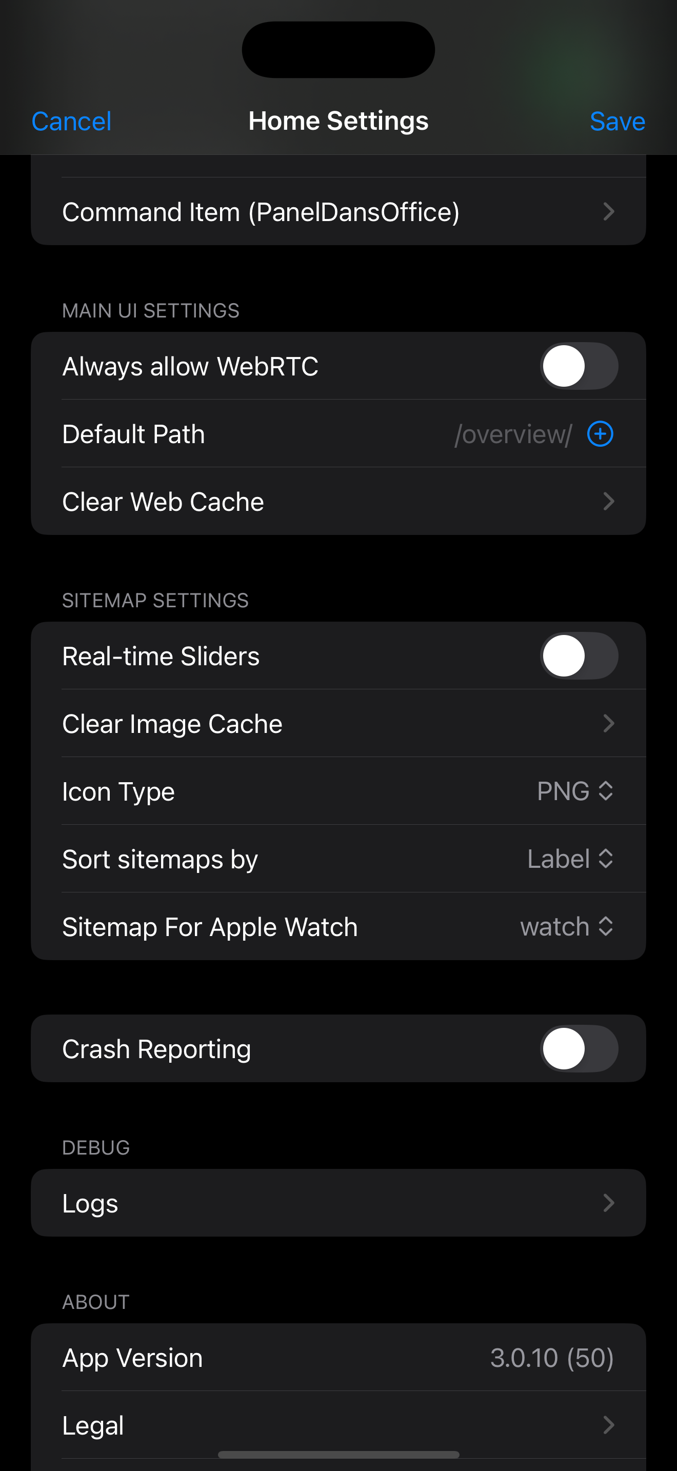

# Crash Reporting
Sends crash reports to Google / Firebase.
# Main UI Settings
# WebRTC
Allows audio and video communications in the Main UI for views and widgets that require it.
# Default Path
Allows the user to enter a path to act as the starting point when the Main UI is loaded. Clicking the "+" button will prompt to enter the current path the of Main UI view.
# Clear Cache
Clears the Main UI web cache.
# Sitemap Settings
# Realtime Sliders
Allows sitemap sliders to send changes as the control is sliding in realtime.
# Image Cache
Clears the sitemap cached images.
# Icon Type
Select which type of icon the sitemap view will attempt to load for icons.
# Sitemap Sorting
Sort order when presenting multiple sitemaps for selection.

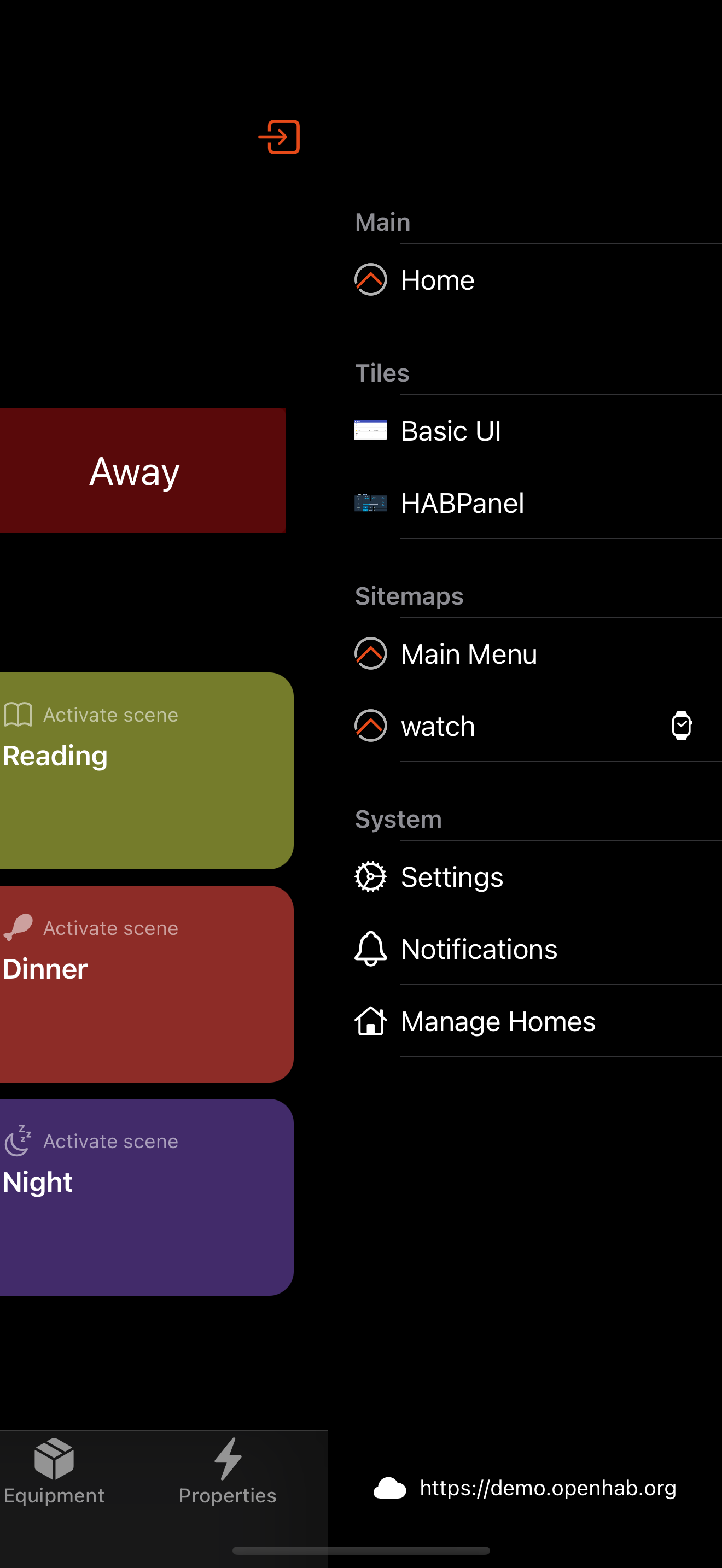

# Main UI and Sitemap Usage
Clicking "Home" will navigate to the Main UI from the user's openHAB system. Clicking this when the Main UI is already visible will force a reload the Main UI.
Tiles are the alternative UIs installed on a user's system and will be opened in an embedded browser.
Sitemaps show the available sitemaps on the users system. Selecting a sitemap will present the native sitemap renderer view.
Notifications is a list of push notification retrieved from the openHAB cloud (if configured).
Settings opens the application settings view.
The app will persist the last primary view opened (Main UI or Sitemaps) when the app is opened or restarted.
