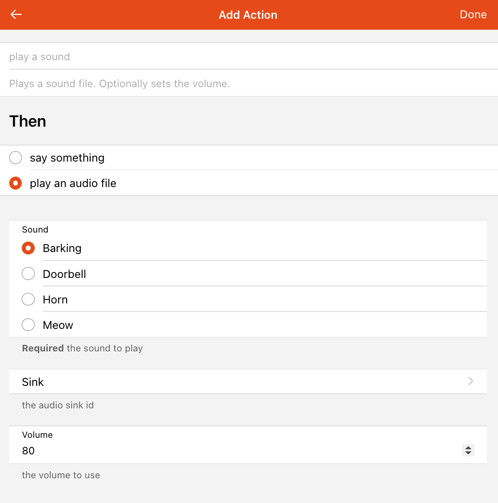

UI-based rules support audio actions as well. Just create or edit a rule, add a new action, select "Audio & Voice" and the UI will then guide you trough the setup:
Audio action setup in the UI
